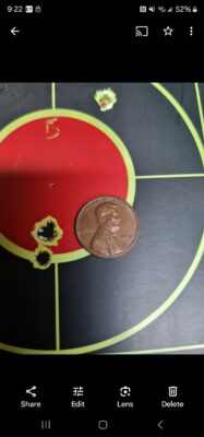

14 BullseyesI have never had a problem using lapua brass when loading .223 in a factory chamber<div>The dies you choose shouldn’t make any difference. I’ve used RCBS Forster and Redding, one of the dies that is often overlooked is the Lee collet die, it perfectly sizes and aligns the neck for outstanding accuracy, i started using one on my practical 20, case prep is everything for accurate ammo.</div>
1st day at the range, doing load development, 5 shots at a 100 yd.
